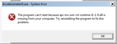

I did as you stated - it said it was installed - restart computer - The following error:
Suggestions?
