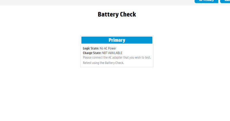

The first few steps didn't work, unfortunately. Here is a screenshot of the battery test result, with the adapter plugged in:
Regarding the second suggestion, I don't appear to have the option "Dynamic Platform and Thermal Framework Setting" ? I have followed the steps correctly - the option isn't there. Why would this be?
