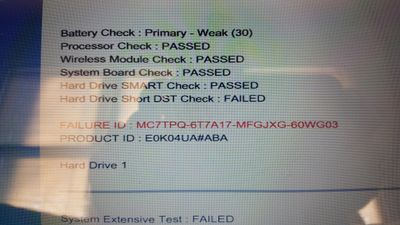

Recently my laptop became non responsive (back lit but blank screen). Was able to run diagnostics and it found a fault with the hard drive.
Failure IDs

I ran HP disc drive diagnostics.
SMART check passes,but the Short DST fails with Failure ID: MC7TPQ-6T7A1C-MFGJXG-60T003.
So its looking more like a Hard Drive replacement time?

Yes, it appears that you will have to replace the hard drive because that utility should install W10 on any make or model PC and on any hard drive that meets the minimum required storage space.
