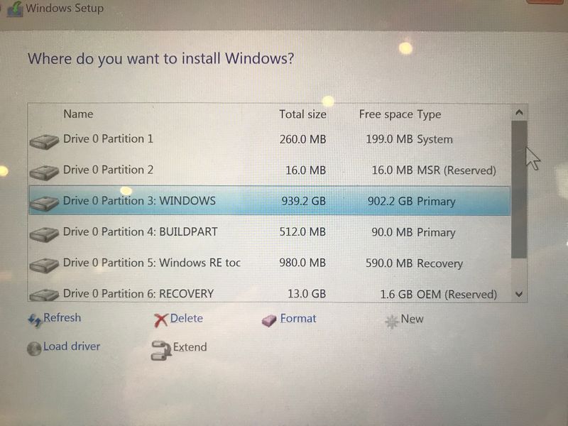

Thanks for the response.  I already have an HP recovery USB, and a Windows 10 recovery USB, and I have just created a gparted USB just in case.    Is the HP Cloud Recovery tool better than the HP Recovery USB?
Just out of interest does this partition setup look normal to you?  it seems very complicated to me, although I havn't installed windows for 10 years or so.

When you clean install W10 (my preferred method, since i don't care to have the bundled software that comes with the HP image), I delete every partition on the hard drive, leaving just one partition of unallocated space, click Next and install W10.
Then I install the drivers and selected software I want from the support page.
When you clean install W10, the recovery partition will not work anymore because the software to access it has been removed by the clean install.
Therefore no need to have a huge waste of drive space occupied by a non-working recovery partition.
Okay, thank you.  I will erase all the partitions, however first I will try with the HP USB as I don't mind the HP stuff. If that fails I will use the vanilla Windows recovery USB.  I'll report back afterwards.  Thanks again.
Okay so after formatting the hard-drive completely with gParted the HP recovery USB still didn't work so I had to format again and reinstall with a standard Windows 10 Recovery USB as you suggested.  All is now working again.
