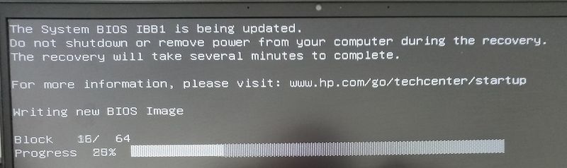

Tried to install many different versions 4-1, 4-3, 4-4, 4-7.
But after flashing I always received these messages:
and
The firmware was installed normally only with version 4-8, but after two reboots - a black screen.
All operations were performed in two configurations:
1. 1TB SSD installed - formatted GPT (NTFS)
2. Without SSD installed.
09-18-2024 07:55 AM - edited 09-18-2024 08:01 AM
I am not sure what I'm looking at. The above images show the flashing stopped at 30, 28 and 28 for three different BIOS?
Was the LED of the USB flashing? if not, then possibly the BIOS on the hard drive was being used instead of the USB bios.
The LED of the USB should be flashing constantly when its is being used. Remove the SDD or HDD to ensure that the USB is being used.
Was there a problem with the system before you did the BIOS upgrade? It would be unusual for the flash to stop like that. A memory failure could cause the flash to stop. Remove memory, use air duster on motherboard, clean memory edges with eraser and put back in. Try another USB that is FAT32 formatted.
