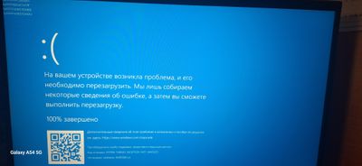

Hello, this problem occurred as soon as I started the laptop.
Yesterday I was playing, everything was fine, but I reinstalled the drivers for the rtx3050 ti video card and in the morning I started the laptop and this error in reboot the system does not enter, the same error appears and it also says that it is already 100% complete but the laptop is just turned on and that’s it
I searched on the Internet but I can’t reboot the system

what test exactly?
I went through everything and it didn’t give me anything, everything works, everything passed the test
You give me links to videos, but I simply cannot go into the boot menu, and if I select system recovery, then nothing will happen. just text and that's it, I can go into the BIOS but I can't boot

I did everything and passed the test in a second, but how many times can I say I can’t log into the system at all and I can’t download anything onto a flash drive, I have one, but how can I download it??
You will have to borrow a  PC and you must be an administrator.  A PC at a library cannot be used.
Try powering the laptop up and then quickly pressing the power off button.  If you do this 3-4 times you can get into windows recovery mode.

You should be able to enter Safe Mode without needing a USB flash drive.
I can send you a video by email what happens if I try to enter the boot menu or recovery system
Now my backlight turns on by itself and when I want to go into this thing where I have to press esc, it’s just an error)
I just had another problem and it has already been removed Wdf01000.sys
Another problem was IRQL NOT LESS OR EQUAL
but she disappeared and the one who was originally appeared
