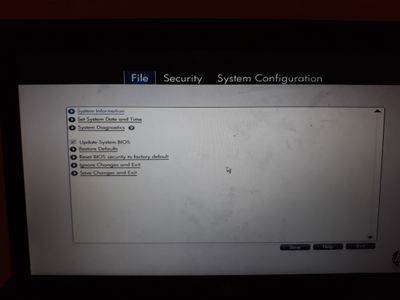

Im stuck fir real, check those pictures and tell me what to do because i dont know, how to reboot, and cant find what are u telling me check:
BIOS Setup (F10):
BOOT DEVICE OPTIONS (F9):
20200216_133926.jpgThe Problem:
@Vaxim
Pressing F9 is the right thing to do, but there are two problems with your screen.
First, I have no idea what Upgrade Bay means, so I can't help with that.
Second, your DVD or USB stick, whichever you are using, does not appear in the Boot Devices list -- and I have no idea why.
You would need to look through your BIOS options and see if there is one that enables/disables booting from portable devices.  IF that is disabled, then your DVD and USB sticks would not appear in the Boot Devices menu.
I am a volunteer and I do not work for, nor represent, HP
