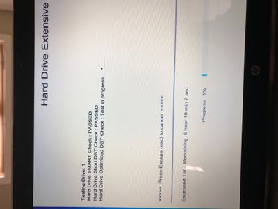

I’m currently doing the test that you mentioned and this is the screen I’m currently seeing. Am I at the right place?  It says six hours so I figured it would be best to ask you then it being not the right option and losing six hours for nothing.
Thanks!

Yes -- that is the right test to run as you want the extensive test to check out the drive.
