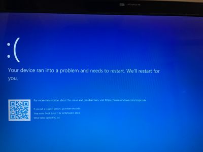

I created Windows 11 bootable USB drive and unfortunately it didn’t work. I got this blue screen msg after booting the usb.
Hello @Laoo
The BSOD is related to Intel Rapid Storage Technology.
