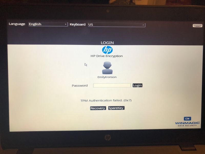

The password that i enter is my login information to my computer.  My username is already displayed and it asks for my password, which i enter and am displayed with TPM authentication failed (0x7).  I will upload a photo

Ok, I think I have an idea now.
I suspect you may have encrypted your drive and this is the prelogin screen.
Is this just a prelogin screen or is because of encrypted drive? Based on your description, the drive should also be encrypted.
If the drive is encrypted (as I suspect), I am unable to help you authenticate against it and login - I do not have the necessary tools, not I can assist you bypass it.

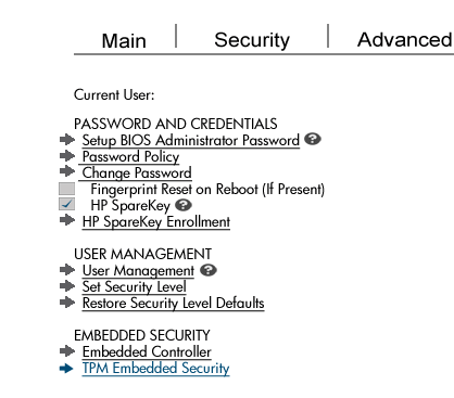

So I tried the first option to try and reinstall the operating system and that did not work
i tried the second option but when I went the the security tab the TPM embedded security button was greyed out (see photo below).  Any help is appreciated.  Thank you!
Also this is the error screen when I try to loginAlso this is the error screen when I try to login
The pictures confirmed my theory.
  • The data on the drive is encrypted and your only option is to reinstall Windows. I am afraid you will not be able to access your files inside as there is no mechanism for data recovery in emergency situations (unless these have been enabled prior to that - Recovery media/HP SpareKey, etc) .
    You will need to restore them from an archive (back up copy) if such exists.
    What operating system you use(d) ? Did it came preinstalled on the PC (OEM Windows) ?
  • With regards to the TPM error and the greyed out TPM option, most likely the TPM chip on the motherboard got corrupted, this would also require service/replacement.
