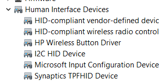

"rollback driver" again via device manager category 'mice and other pointing devices'.
After that, roll back, try searching for the 'software components' type driver in the Microsoft Update Catalog. Look for the same version as your laptop's touchpad driver version.
I forgot to give you the Human Interface Devices type touchpad driver, that's why it doesn't work.
but if you want to rollback, that's okay, you just need to look for supporting drivers for the touchpad driver, the Human Interface Devices type touchpad driver and Software components.
Make sure you install the version for the touchpad support driver with the same driver in the mice, and other pointing devices category.
Look at my picture, the left is the properties of the touchpad driver type software components, the middle is the type mice and other pointing devices, the right is the type human interface devices.
