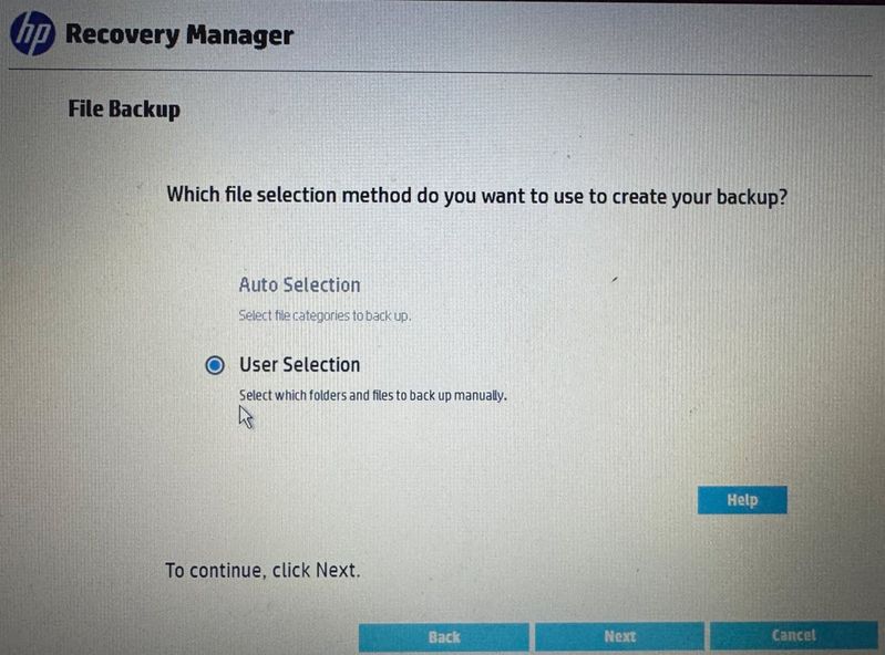

Including all screenshots for any other person having the same problem. The root cause was the missing storage drivers which might have been corrupted because of an update ( 2 laptops at the same time).
BitLocker is tied to my microsoft account.
I created recovery USB for the product ID for my laptops again but it didn't work. No drive corruption indication.
I created the Windows Media Creation tool but while trying to install Windows, it couldn't find any drive.
The list disk command doesn't show the hard drive.
I downloaded the storage drivers from this link (specific to my laptop model).
Newer IRST drive wasn't recognized.
Copied the F6 Folder (also VMD and HasExtension folders as another HP Support person advised to try those if F6 doesn't work) into the root folder of the Windows Media Creation tool usb.
When Load driver option came up, I browsed to the usb->F6 folder
1st and the 2nd driver installed giving the below options . (In the other computer the 4th partition doesn't show as recovery but unallocated)
Since I installed the driver , instead of continuing with the windows installation, I tried the HP cloud recovery tool hoping to save my data. Also, the installation process shows that I have Windows 11, not 10 as I had previously thought.
Since no data was found for backup, I had no choice but to use the Factory Reset option.
However, when installing the windows, it asked to sign in to my microsoft account and then it showed a message that I have backup of my old laptop with microsoft that could be copied over. I selected that option and got my data back.
Having one drive enabled with microsoft helped regain the data.
Thanks for your help in the process.
