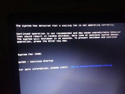

Hello @Suidubaz
In your case: Service is required !
- The computer should be disassembled and checked.
- Thermal paste for CPU GPU and bridges should be renewed
- The function of the fan(s) must be checked
- General cleaning ...
If you can't do that, you should have it serviced by a professional notebook (chip level) repair store.
Good luck
