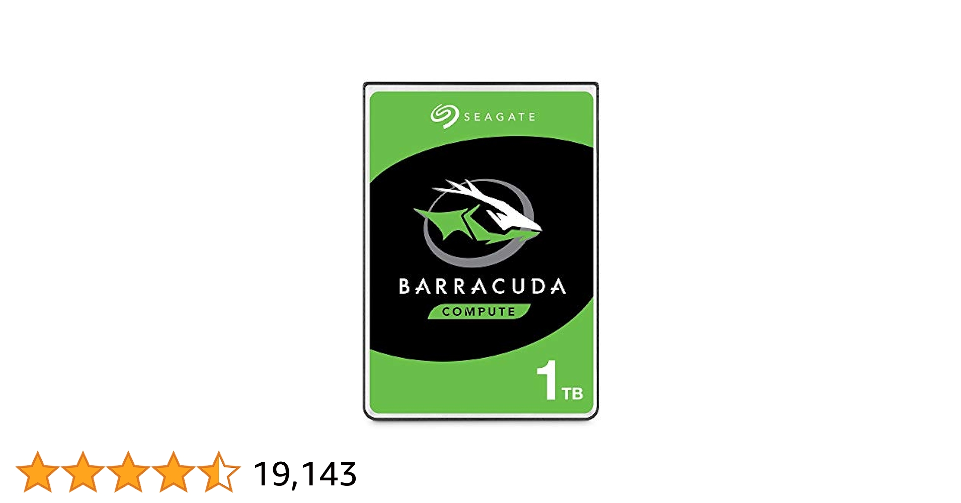

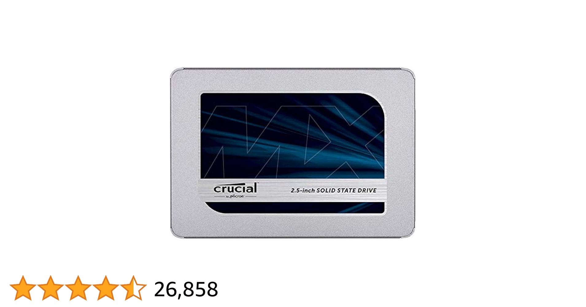

Ok. I see that it is not a brand new notebook. So it is the Hard Drive which has failed and needs to be replaced.
Here is a guide on how you can do this. What you need is a new 2.5" Hard Drive or if you want to greatly increase the performance of the PC you could use a 2.5" SATA3 SSD.
Examples:
https://www.amazon.com/Seagate-BarraCuda-Internal-Hard-Drive/dp/B07H28QRKN/ref=dp_ob_title_ce
https://www.amazon.com/Crucial-MX500-500GB-NAND-Internal/dp/B0784SLQM6/ref=sr_1_2?crid=184962H9H6KFC...
