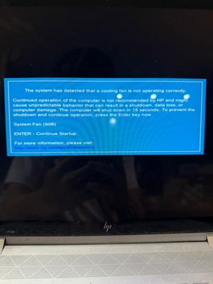

The “System Fan (90B)” error means your HP device has detected that the cooling fan isn’t functioning properly. This can lead to overheating and potential damage if not addressed.

If the fan remains non-functional after cleaning and BIOS updates, it may need replacement.
Let me know your exact model number and I can guide you to the correct part or service options. I’ll stay with you until your system is cool, quiet, and running safely again.
