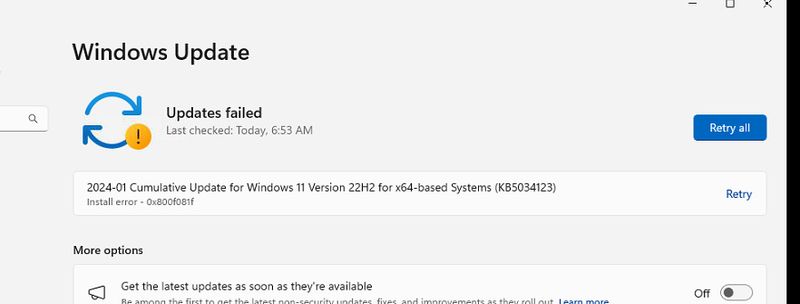

i apologize, the update is actually the CUMULATIVE UPDATE for 22H2.  22H2 is on the machine, but this cumulative 01-2024 update is what is failing...
Gotcha.
What is the KB number of the update that is failing?
see attached.  shows the failure notice.  BUT, i followed the advice above, and DID the windows update, and the SYSTEM states that it is now at 23H2 (system -> about).
SO, the question is, will this notification eventually disappear, so that it does not try to go RETRO backwards?
but it looks like the forced update with the microsoft update link did the job !

Hi, Nick:
Here's what I would do if I were you and I have done this a few times when MS updates failed--especially on cumulative updates, because February's update will have the January files as well, so you're not really going to miss anything if the Feb update works...
Run the Microsoft Hide Windows update utility that I zipped up and attached below.
It will find the update that is trying to install.
Check the box to hide the update.
The utility will run again and report that the problem is 'Fixed.'
Restart the PC, go to the Windows update setting and run the update again.
You may have to click on the 'Retry' button a few times, but eventually the update will be cleared out.
thanks for reply.
right now, i'm going to just ignore that update, and see if it disapears on its own, since 23h2 got installed.
i did download the zip file, and instructions, and will thry that if the issue continues.
again, thanks very much !!
