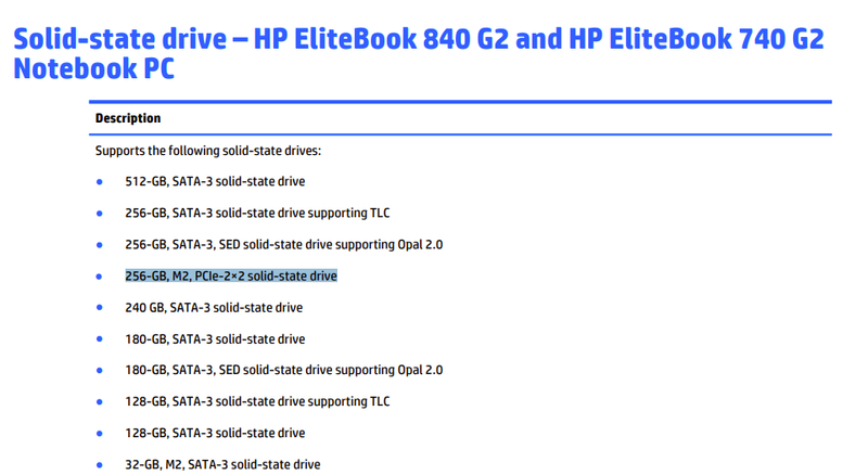

@Firdous307:
Your model does support M.2 PCie SSD. See below manual for your model and screen shot of page 6, which shows M.2 PCIe SSD gen 2x2 is supported. If yours is an M.2 PCIe gen 3, it still runs but at speed of gen 2.
HP EliteBook 840 G2 Notebook PCHP EliteBook 740 G2 Notebook PCHP ZBook 14 G2 Mobile Workstation Main...
