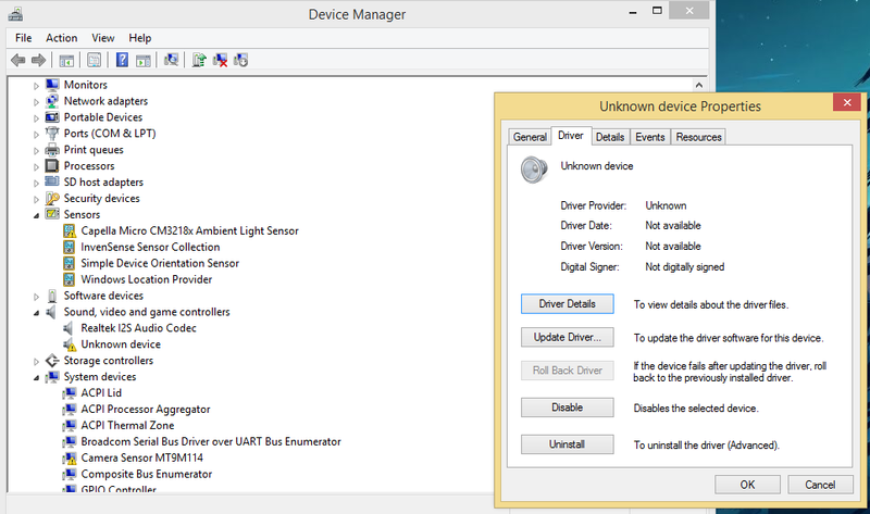

Hello , me again , i upgraded from windows 8.1 with bing to windows 8.1 with a product key
i downloaded drivers from hp site ( for my product hp pavilion x2 10 j000na ) installed all but there is a problem with audio driver / they installed me realteck I2S audio Codec and there is one more ,, Unknown device" if i connect my headphones nothing is happening but if i connect with an usb audio all is working fine
The speakers was working fine before update

Hi:
The driver you need is located inside the chipset driver file, so see if this works...
I pulled the driver out of the exe file, zipped it up and attached it below.
Download and unzip the file to its folder.
Do not do anything with the files in the folder.
Go to the device manager, click on the unknown device.
Click on the driver tab.  Click on Update driver.
Select the Browse my computer for driver software option, and browse to the driver folder you unzipped.
Make sure the Include subfolders box is checked and the driver should install.
Then restart the PC.

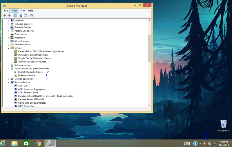

Hi:
Please post the hardware ID for the unknown device.
Use this guide to find that information.
https://www.howtogeek.com/193798/how-to-find-drivers-for-unknown-devices-in-the-device-manager/
ACPI\VEN_8086&DEV_0F28&SUBSYS_103C8011

Hi:
Here is a partial copy and paste of the driver setup information file which shows driver support for the hardware ID you posted...

you are awesome
problem solved
