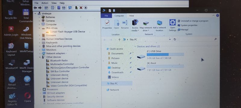

Hi, my HP 14s got 3FO error and followed all instructions to get a HP Recovery USB Boot drive. However, when boot the screen flashed a few time and then the above message [startnet] Error, Get failure from Dynamic Recovery Tool displayed.
Tried using WinPE WinPE 11-10-8 Sergei Strelec but cannot find the original eMMC hard disk either (see photo), It's noted that a few devices are not functioning in WinPE, not sure if it's related to the eMMC failure. Also a Youtube showed eMMC drivers needed for HP14s 64G eMMC hard drive (without SATA or SSD) but didn't catch how it's done. Appreciate further suggestion and guidance. Thanks. Device shown in HP.jpg

Unfortunately, I believe the drive has failed.
W10 doesn't need any drivers to install on an eMMC drive.
I have a HP Stream Pro 11 G4 notebook with a 64 GB eMMC drive and have installed W10/W11 numerous times on the PC with no problem.
The only suggestions I can offer would be to:
1. Run the hard drive diagnostics test (F2) and see what it reports.
2.  If the drive passes the tests, try clean installing W10 by making a plain bootable W10 installation flash drive with the Media creation tool from the link below:
Download Windows 10 (microsoft.com)
If you can get W10 to install that way, you can install the drivers and available software from your notebook's support page.
