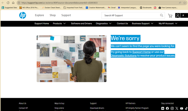

Hi there, the link that you have provided for creating a bootable USB drive, is broken.
The message is see there is:  We're sorry
We can't seem to find the page you were looking for.
Try going back to Support Home or use our Diagnostic Solutions to resolve your product issues.
