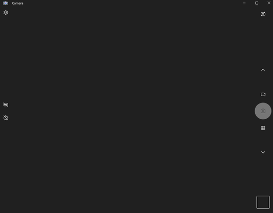

I cannot get the built in camera on my HP envy to work. Its just all of a sudden stopped working. I can open the camera app but I get a black screen. I have checked device manager and the built in camera does not appear, yet when checking for missing drivers HP says the laptop has all drivers up to date.
I dont have a privacy camera setting on the side of the laptop or F13 to press as stated in other guides.
I dont get an error message and I have tried resetting to factory settings. I have completed rebooted my laptop and I am up to date on all windows updates. I have removed the camera drivers and restarted so they would be reinstalled and again only a usb camera driver appears. I have had no luck! Any advice please

@LisaBaker1991, Hello and welcome to the HP Support Community!
Thanks for posting your question. I'm here to help you get things back on track.
I understand how frustrating it can be when your built-in camera suddenly stops working. You've already done a great job troubleshooting, let’s go a few steps deeper to try and resolve this.
Show Hidden Devices in Device Manager
Sometimes the camera is hidden due to a driver issue:
  1. Press Windows + X → Select Device Manager
  2. Click View → Select Show hidden devices
  3. Expand Imaging Devices, Cameras, or Sound, video and game controllers
  4. If the camera appears grayed out, right-click and select Enable device
Check BIOS Camera Settings
Some HP laptops allow enabling/disabling the camera from BIOS:
  1. Restart your laptop and press Esc repeatedly, then F10 to enter BIOS
  2. Navigate to Advanced or Security tab
  3. Look for Built-in Device Options or Camera settings
  4. Ensure the camera is enabled
  5. Save and exit BIOS
Use HP PC Hardware Diagnostics UEFI
This helps check if the camera hardware is detected:
  1. Turn off the laptop
  2. Press Esc repeatedly, then F2 to open HP PC Hardware Diagnostics
  3. Select Component TestsCamera
  4. Run the test and note any error codes
Manually Install Camera Driver
Even if HP Support Assistant says drivers are up to date, try manually installing:
  • Go to the HP Support Page
  • Download and install the Realtek IR Camera Driver or Intel Imaging Signal Processor (if available)
  • Restart your laptop
Check Windows Privacy Settings
  1. Go to SettingsPrivacy & SecurityCamera
  2. Ensure Camera access and Let apps access your camera are turned On
  3. Scroll down and ensure Camera access for desktop apps is also On
Windows Hello Face Unavailable
This is likely related to the camera issue. Once the IR camera is detected again, Windows Hello should become available. If not:
  • Go to SettingsAccountsSign-in options
  • Under Windows Hello Face, check if it becomes available after reinstalling the camera driver
If the camera is still not detected in BIOS or HP Diagnostics, it could be a hardware failure. In that case, please visit the nearest HP authorized service center, the service team will check and assist you.
