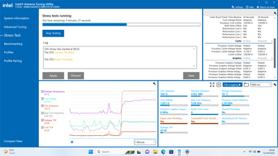

My laptop is getting slower when I plugged in AC adapter. I have tried everything on internet that mentioned about. Like downgrade or upgrade the bios, change power plan, use Throttlestop to undervolted and anything else (BD Prochot, tdp, etc). But still nothing changes about. Let's check out the image i provide with.
I did a stress test here with unplugged ac adapter, it seems normal. But when i am testing it with plugged ac.
It just preventing from getting hotter and getting more clock speed. And as you can see the tdp is much smaller than the unplugged one. Can someone help me? thank you

Thanks for responding to my post. I tried to charge with my friend's ac adapter that have 200W (mine 150W). It looks no having issue with it. Could be the ac adapter issues right? Or something else? Cause i want to buy it from online store if it is related to charger issues.
