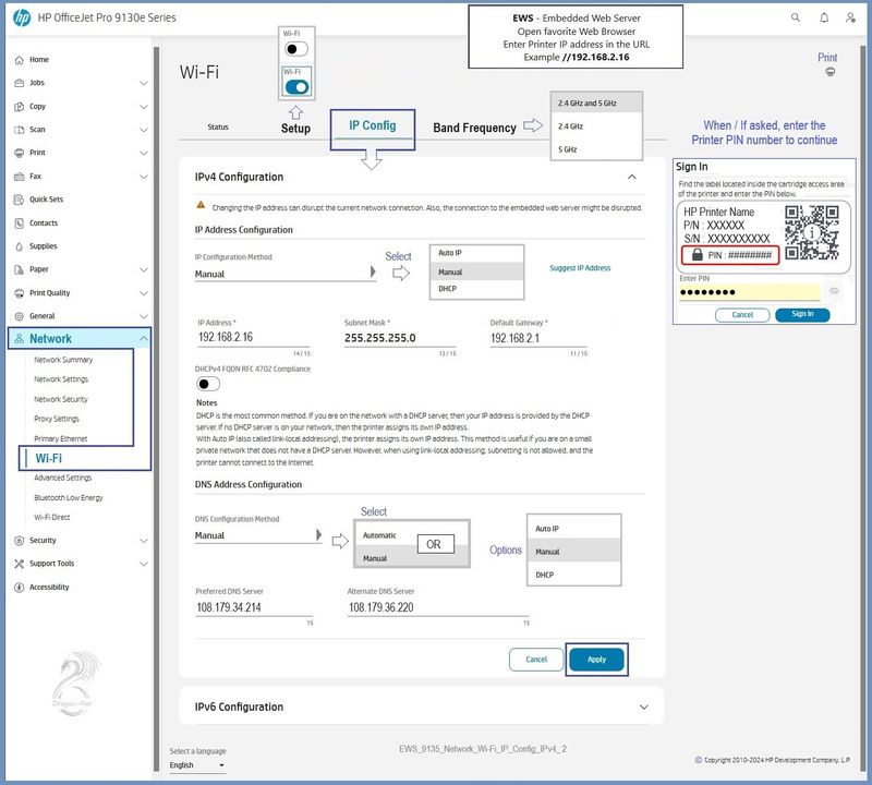

True -- If you cannot add the printer to your network, everything else is more difficult.
Perhaps go in from the router side -- sign into your router,
Add the printer and assign the IP address you want the printer to use.
Presumably, unless you have assigned a different manual / static IP address to the printer -- for example, using the Printer Control Panel or the Embedded Web Server - then when the printer is Restarted, it might simply see the router's assignment waiting for it and connect to the network using the IP address assigned by the router.
What else?
You can restore the network defaults for the printer.
 User Guide - HP OfficeJet Pro 9120e Series
Page 109 - Restore settings
Next,
Use the Embedded Web Server (EWS) to manage the IP Address
Example – Alternate EWS format (Select new printers and some Laser Printers)
Open your Browser > Type / enter the Printer IP address into URL / Address bar
Section Network > Primary Ethernet > Check / Adjust Status and other tabs...
Section Network > Wi-Fi > Section IP Config > IPv4
Notes
  • It is not mandatory that you use a manual / static IP address.  Doing so can improve stability.
  • If needful and if supported, set the Band Frequency to the frequency you want the printer to use.
 EWS_9135_Network_Wi-Fi_IP_Config_IPv4_2EWS_9135_Network_Wi-Fi_IP_Config_IPv4_2
