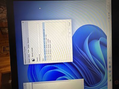

Go to the device manager.
When the Wi-Fi adapter needs a driver, there will be a device listed in the device manager labeled as a Network Controller.
Find that device and post the hardware ID for the Network controller so I can figure out what driver it needs.
Use this guide for how to find the hardware ID for a device:
How to Find Drivers for Unknown Devices in the Device Manager (howtogeek.com)
 Can u read them from the photo or do u need me to type them out?
Yes, I can see them fine.
Here is the link to the Wi-Fi driver you need:
Realtek RTL8xxx Wireless LAN Drivers
https://ftp.hp.com/pub/softpaq/sp149501-150000/sp149501.exe
