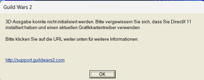

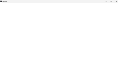

A couple of weeks ago I tried installing an old game via Steam (Sacred Gold). On the first start of the game Steam tried installing an old Directx version (D3D9); the installation crashed. I don't know if it's connected to this issue but the problems started piling up after this. I'm not able to open Geforce Experience (black screen) and I can't run some games like Guild Wars 2 and Valheim. Other games like Cyberpunk and Last Epoch work just fine. Funny enough, the game that presumably caused all of this works as well now...

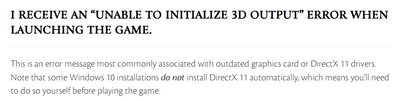

Guild Wars 2:
It wants me to ensure that DirectX 11 and a current graphics driver is installed
Valheim:
Only white screen and no response. However, it works with Vulkan.
