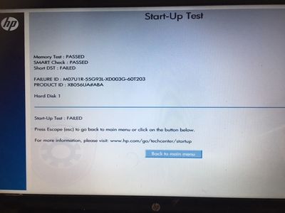

Hello everyone,
Recently I am having an issue with my HP G42-23OUS Notebook, everything is up to date but yesterday it won't startup completely. It's stuck on a blue screen if I choose to launch repair or if I choose to start my laptop normally it will be stuck on the screen with Microsoft Windows on it. Maybe my laptop being 7 or 8 yrs old is the problem? I had gotten it fixed once at a computer repair  service for batter replacement and the fan. I choose to bring it to a repair shop because I loved it so much. Abdul, tech guy said my laptop's issue could be 6 different issues:
1) Bad device drivers, could be graphics card driver,
2) Bad RAM
3) Windows updates
4) Virus/spyware
5) Registry corruptions
6) bad hard drive
The responses from HP + Miscrosoft were to try several steps in the links including run a diagnostic, resettin/ reinstall to perfom a system recovery my laptop. Create an installation media from a flash drive or dvd. I never experienced this kind of issue before so I sent a mesage to both Micorsoft and HP Tech support via Twitter. Then I tried the start up test on my laptop which said something failed on my latop. I am still not sure if its an hardware issue? Do I need to replace the hard drive? Was there corruptions? It can't be a virus or spyware? Bad device, driver graphics?
This is what get now...This is what get now...If choose to start up normally I  get this screenIf choose to start up normally I get this screenIf I choose to launch repair I get this screenIf I choose to launch repair I get this screenReseult of the Start up TestReseult of the Start up Test
This is due to your hard drive failing.  You should see if you can backup your data using a different PC and then replace the hard drive.  Any 2.5 Inch Sata 3 hard drive will work.
