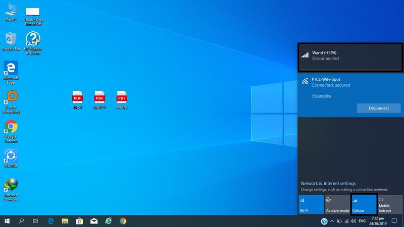

:An update:
Following drivers installed perfectly, but Cellular Data turned off. Any solution or advice?
"Sierra Wireless Driver Package for HP un2430 Mobile Broadband sp79200"
Finally connected through the Cellular connection after installing the drivers mentioned in the last post ("Sierra Wireless Driver Package for HP un2430 Mobile Broadband sp79200") on my HP EliteBook 8470p and turned on the cellular data through the windows network manager. Problem in the connectivity through the cellular connection has been solved though HP Mobile Data Protection Sensor drivers are not fully compatible with the Windows 10.
Solved Cellular Data ConnectedSolved Cellular Data Connected
