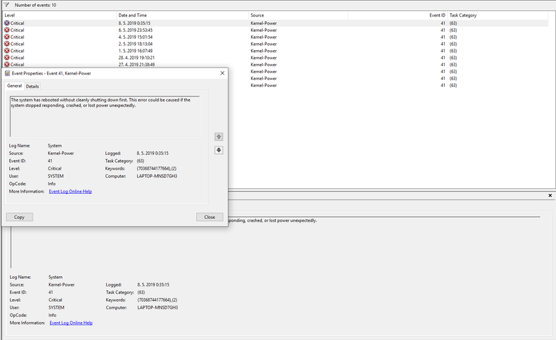

Okay, so linux is working fine, couple days without problems, i think problems start after i done update to 1809,
I found this in the event log, just after I turned it on again.
temps are always around 50-60°C, so that errors doesn't make sense.
i´ll try to instal clean version Windows 10 Home with older build 1803.

In this scenario, you are correct as this could be an issue with the Operating system. I would personally suggest you perform a recovery using the recovery media.
