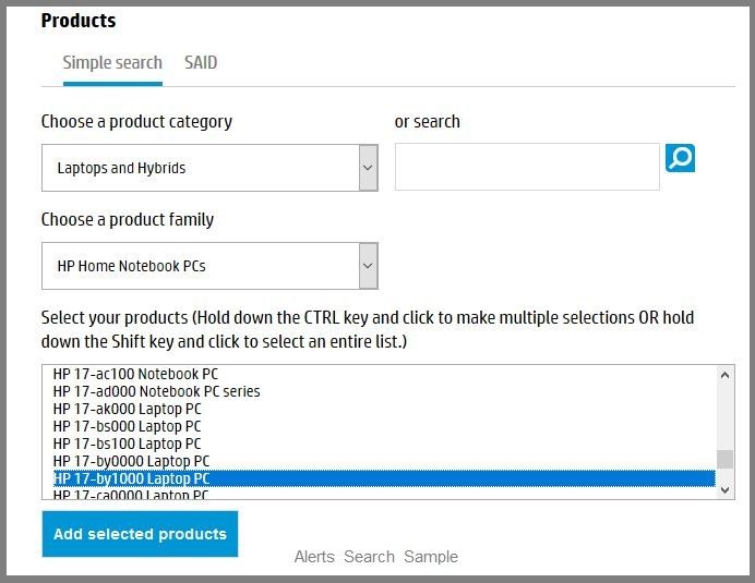

If available for your computer, you might sign up for "Alerts" to be notified of important updates / software.
Get connected with updates from HP
Alerts_Search_SampleAlerts_Search_Sample
