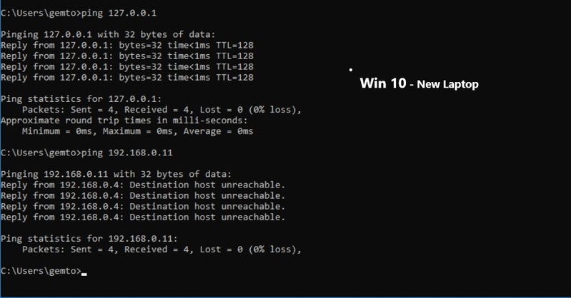

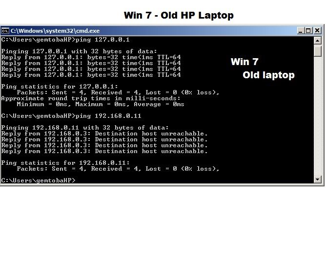

Thanks for the beginning step instruction.  As advised, I pinged both laptops.  The following pics are the results.  I'm sorry I do not understand this, hopefully done correctly.  It appears the Ping 127 worked on both laptops.... however, the Ping 192 for each laptop indicate "destination Host unreachable".
Wondering if I was to have done one of the suggestions mentioned yesterday prior to doing both of these pings.

Hi
The 127.0.0.1 is a loopback test, it sends and receives internally, indicating a working adapter in both PC's.
Now you need to know the configuration of each PC, and hopefully this works.  Write down the numbers as well as posting them.
WinKey + R and type cmd.exe   pause
ipconfig
and this block is what is wanted
  IPv4 Address. . . . . . . . . . . : 192.168.0.XXX
   Subnet Mask . . . . . . . . . . . : 255.255.255.XXX
   Default Gateway . . . . . . . . . : 192.168.0.XXX
Whatever your numbers are.  Please post them.
