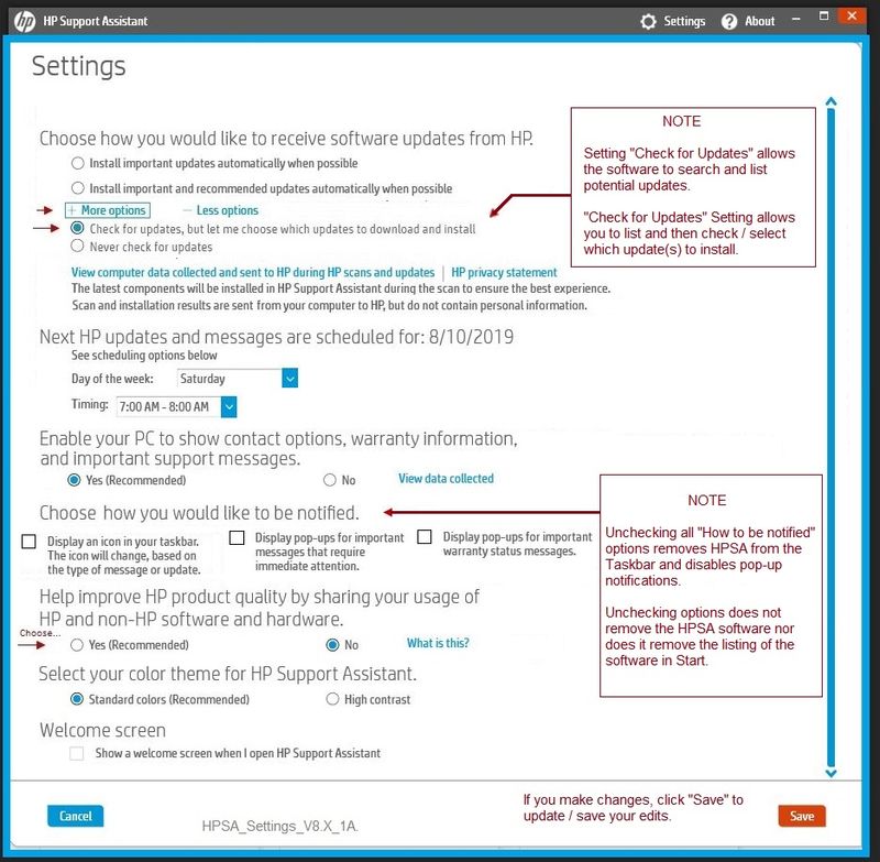

In the opened HP Support Assistant ,
Click Settings gear wheel > Check / Adjust how you want the program to behave > Save any changes
For example,
Section Choose how you would like to be notified
HPSA_Settings_V8.X_1AHPSA_Settings_V8.X_1A
