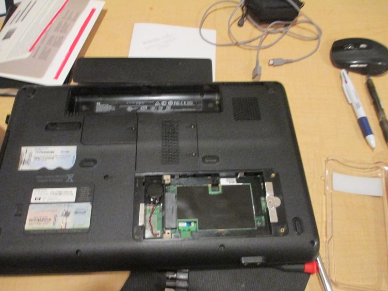

Sir's I'm looking for a OEM CMOS Battery, for My  Laptop, a G60-120US.. I've tryed a E-Bay Battery, Did not attach properly, And a Newegg and one from a Battery site, None where the correct Battery. I've tryed to contact HP with No luck. Thank You Sir's.......Need New CMOS Battery.Need New CMOS Battery.

Hi:
Below is the link to the service manual for your notebook's model series.
488764-003.book (hp.com)
The RTC (CMOS) battery is part number 501587-001.
You can see it listed on page 3-6.
Where you are going to find that battery, unfortunately that I do not know.
You will have to see if the batteries listed under that part number on eBay match the one you have.
501587-001 | eBay
