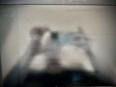

I apologize about not getting back to you sooner.  I have attempted to do this, however, I cannot make out what is going on on the screen.  I took a picture and then applied multiple filters and such to try to be able to read what it says, however, I believe it is just telling me what is going to be tested.  If I could get the screen, even a little brighter I could probably work on it and get things working but I can't even see what it is saying or doing so I am unable to successfully pick what I need to pick.   I have included the picture I took and modified.
Hello @tchikukwa
This is HP diagnostic quick test...
