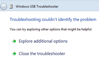

I am running Windows 7 Home Premium SP1 64-bit (freshly installed) on my HP Pavilion Dv6-7138us (AMD A10-4600M, 6GB RAM).  I've just finished installing all updates to get it up to speed but it looks like the drivers for the laptop's USB 3.0 ports are not present/installed.  I am having a bit of a difficult time diagnosing the issue as nothing seems to be helping.  The view from Device Manager:
I assume the USB 3.0 ports are the USB controllers listed in "Other Devices."  When I try to update the drivers however I get this:
Per these instructions, I ran Microsoft USB Fix-It but the tool detected no issues:
Windows Update insists that there are no drivers to be updated.  The product page for this particular laptop on the HP site also does not list any USB drivers to be installed so I am at a loss.
Any help would be greatly appreciated.  Thank you so much.
