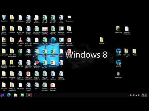

You can also watch this video and try the steps in the video to get the Ralink BT to work:

The only suggestion I can offer if you installed the W10 driver, would be to uninstall the driver and try the method in the video to install the generic Bluetooth driver from W10's driver database.
Apparently the W10 driver no longer works with the newer builds of W10.
If that doesn't work, you will either have to replace the Ralink Wi-Fi adapter with one that works better on W10, or you can use a USB Bluetooth adapter.
