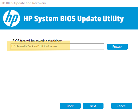

I have an additional question: the link you gave does not give the separate bin- and signature files but an install file. Does the installation of this file allow the copying of the bin- and signature files to the HP_TOOLS USB?
The sp115284 just installs the Diagnostics UEFI tool to a usb drive and doesn't install any specific update bios files.
You can follow the steps below to update bios:
1. Connect the usb drive with the Diag. UEFI ver 8.2.0.0 installed and run an update bios file.
2. When you come to the screen that displays three options; Update, Create Recovery USB Flash Drive and Copy,
select Copy.
3.Click Browse and navigate to \HP_TOOLS\Hewlett-Packard\BIOS\Current and click Next.
[Edit]4. You should see the screen as shown below. Your usb drive (HP_TOOLS)'s letter may be D, E or F. Click Next and a bios bin file and signature file(s) will be placed in the aforementioned folder directory.
5. Restart the laptop, tap F2 to boot into the Diagnostics UEFI from the usb drive, and click Firmware Management.
[Edit] 6. Go to "Updating the BIOS Manually from a USB Drive (Outside of Windows)" in the 2nd link in my previous post then see No.6 in the section "Update the BIOS with a USB Flash Drive" and follow the subsequent instructions there.
