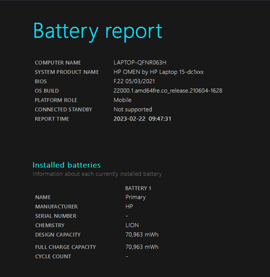

Can you run a battery report and see who made it?
Please run the battery report and post  the summery
you run the battery report by bringing up the administrator command windows "cmd" and running powercfg/batteryreport as shown below
After entering that explorer line you should see something like the following. You will have to click on it as it is long
https://stateson.net/docs/SP4_battery-report.html
You can use the WindowsKey + shift + S to copy and paste a small image if you want to post anything.

I ran the battery report and it seems to be fine(see image below).

The battery report does not show a serial number.  That is suspicious.  I assume you got the HP battery from a legitimate vendor.

Your battery report still shows F22 which is OK as it fixes a problem with the battery supposedly

Can you run another battery report?  I just sent a "friend request".  If you accept it you should be able to send me a personal message and attach the full battery report.    It is too long to post here and I might be able to spot a problem.

I believe there is a problem with the battery.  The serial number should be reported by the battery report.  You might want to read the comment under this youtube video.
