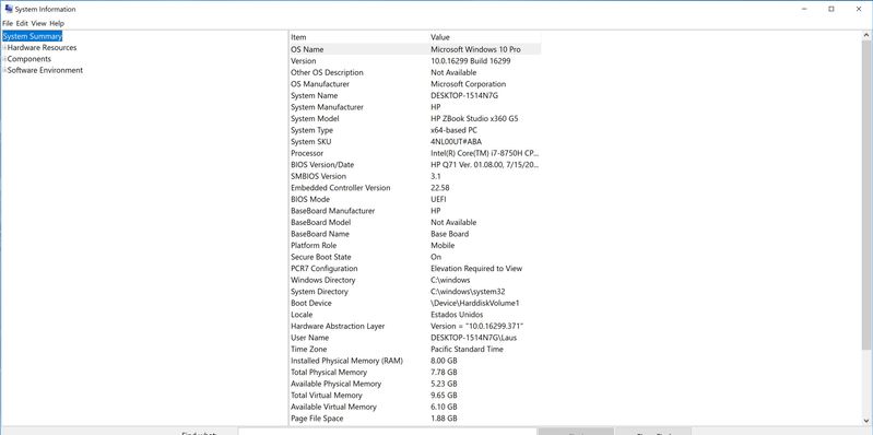

Tell you that I updated the BIOS version, before it was with version 01.07.00 now it looked like this:
