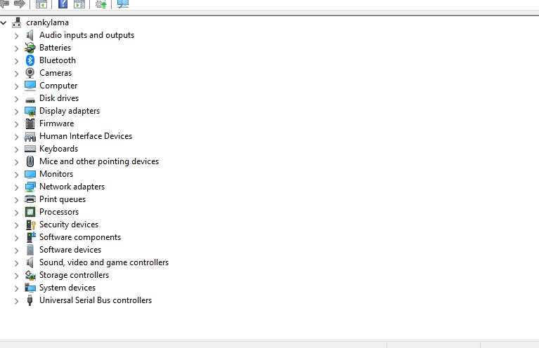

(2) Start windows <device manager>
- Open <Disk drives>
- Open <Display adapters>
- Open <Monitors>
- Open <Network adapters>
- Open <Sound, video and game controllers>
--->>> Send screenshot
(3Please report your results
