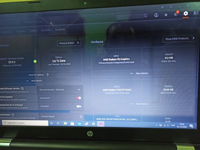

I have it running on HP Pavilion Notebook - 15-ab115ur
 see, when playing games it shows only memory of integrated graphics, i.e. 500 mb
But I have discrete graphic of 2 GB  which is not present here.
 and here I also do not have option to switch to discrete graphics by using high performance.
Please suggest solution for this.
Currently, Windows 10 does not work correctly with Dual Graphics. The toggle setting you showed doesn't work. The only thing that makes a discrete graphics card work is switching to maximum performance in the advanced power plan settings. Do this and see with the FPS Monitor that the second video card is working.
