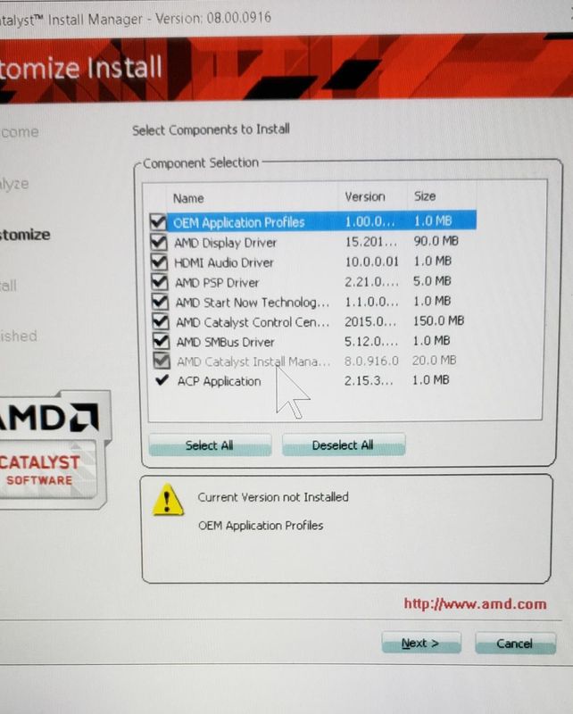

Sorry for no progress update fro me in the the last few days....I got busy
Well I installed the sp72773.exe driver file on my friends Pavillion laptop...
I got further than I had ever before and it started to install the Catalyst software and all....but sadly STILL getting BSOD blue screen of death for "Bad Pool Caller" error
So now I m really at a loss as to what to do next?
See screen caps below
Please help with any suggestions!! this "project" has now gone on FAR too long
Catalyst Install Pix 2Catalyst Install Pix 2Catalyst Software install Pix 1Catalyst Software install Pix 1Bad Pool Caller after install of sp72773.exeBad Pool Caller after install of sp72773.exe
