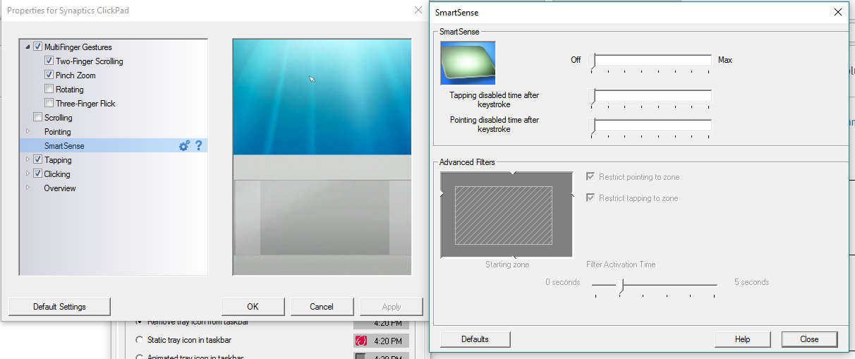

Hello, can't disable palmguard on my notebook.
Basically whatever i do mouse freezes after 1 second, whenever i press any key on my keyboard.
I try to update Synaptics touchpad driver on one from syanptics website, but without any sucess.
Is anything can be done with this issue?
I'm working in a field of realtime graphics, and i can't move camera in the renderer from touchpad because of that... Only with mouse... Please help!
palmguard settings
Solved! Go to Solution.

04-11-2017 05:27 AM
Hi guys, seems i did sorted the issue!
So steps to reproduce were:
Go to driver manger uninstall remove - erase ClickPad driver (without saving it to the disc)
Reboot
Run Assistant, it do installs new driver out there
Reboot
go to Mouse & Touchpad settings disable palm guard, now it works!
