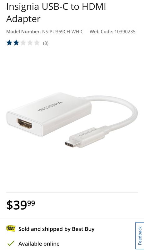

Hi EddyK,
The product number is W7D92UA.
This is the USB  adapter I used.This is the USB adapter I used.
 Thanks in advance for your help!

Hello @KimKJ,
Glad to be of assistance.
I took a look at your computer's Specifications and I regret to inform you that this laptop's USB-C port is a standard USB 3.0 port incapable of DisplayPort Alternate Mode. This is further justified by the fact that there is no mention of USB-C display output in this computer's Maintenance and Service Guide.
Unfortunately, USB-C is simply a connector type and doesn't say anything about the actual functionality. This is where a lot of people get confused.
I urge you to return the USB-C to HDMI adapter. What I can suggest for a dual monitor setup is purchasing a USB 3.0 to HDMI adapter such as this. However, one thing I should say is that these may be a bit unstable and I cannot guarantee flawless functionality although the reviews seem to be generally positive.
Hope this answers your question,
Eddy

Hi EddyK,
Thanks for your help!
I ordered the mentioned adapter and would try it once received.  I will let you know if it works.

Hi Eddy,
Bravo, it works well, thanks again for your help!
KimKJ
