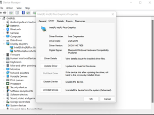

I have received a new docking station, but I am having some trouble connecting my monitor to it.
the driver:
The Graphic card:

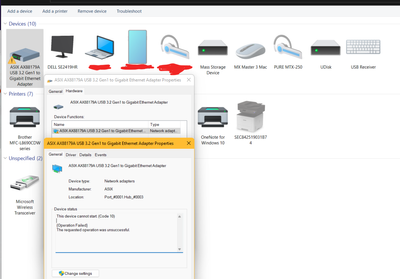

And this is my problem:
The docking station working excellent in my second leptop:
so the docking station is fine.

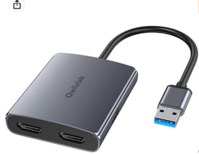

If i connect USB-A to HDMI adapter like this:
it can work for 2 screen?
