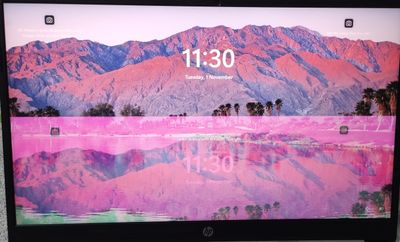

Hi, i am facing this display issue. Seems like display is duplicating from bottom half of the screen with an other color. I tried uninstalling/updating display driver, resetting windows, etc. Anybody has any idea?

Hi @Ub6424, I am not able to test using a external lonitor right now. But when i took screenshots or share screen, screen is displaying fine.

In the simplest case the internal display cable behind the screen is no longer seated correctly. It has come loose slightly.
Recommendation and solution
In your case: Service is required !
- The computer should be disassembled and checked.
[Always recommended] Thermal paste for CPU GPU and bridges should be renewed
[Always recommended] The function of the fan(s) must be checked
The internal display cable that goes from motherboard to screen has to be checked or replaced
The screen has to checked or replaced
