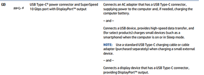

Banhien - Thank you for your reply.  I read discrepancies in the HP documentation about the specifications of what is supported and what is not.
Specs I read about my laptop as per the HP service guide for that USB-C port 3.2 gen 2
The HP User Guide Specs for the USB-C v3.2 gen 2
So I understand HP is using the lightening bolt to represent power delivery for that port.  It is not meant to represent the Thunderbolt symbol and all the industry standards for support of a Thunderbolt port.  So can I charge and run the laptop through that USB-C port using a USB-C dock with Power Delivery granted the correct DC voltage and current is provided without having the HP AC-DC power adapter connected to the cylindrical DC power port?

So I am asking clarification on what the USB-C 3.2 gen 2 supports.  You mention it supports super speed data transfers, power delivery, HP sleep n Charge.  The next two bullets below the USB-C port description are in your reply:
  • DisplayPort 1.4 out up to 4096 × 2304 @ 60 Hz through adapter;
  • HDMI 2.0 out up to 3840 × 2160 @ 60 Hz with HDCP 2.2 through adapter;
 Are these two protocols supported through the USB-C port via an adapter?   Please confirm for that would help understand what was configured to order (CTO) as you mention in other posts what CTO means and specifically what my CTO laptop supports.
