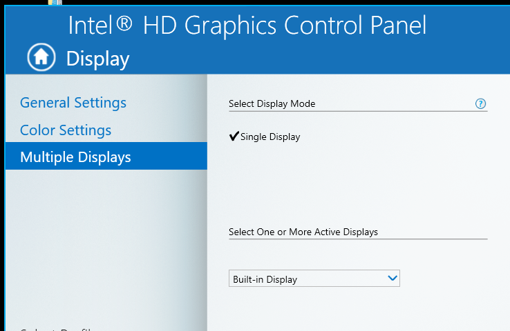

When I connect the monitor via the USB C cable, I am able to "see it" as an option in the Display Settings, but when I try to output to it, the settings just revert back to "in built display".
Before connecting the USB-C cable connected to the monitor:
After a connect the USB-C, option to Extend or Clone the display:
But if I select the options above, and "apply", it reverts back to to single display:

So my Work IT Service just installed the drivers as Admin, but I still have the same issue.
Has anyone got any suggestions?
