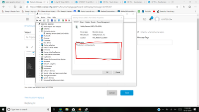

To help you in detail, Can u please take a screen shot of "Device Manager".
So i can help u better! (I know the problem & know the solution but before that i must have to check what exactly going on)
Here's how to take screenshot>
press & hold Windows key and then press X key on your keyboard to open shortcuts.
Win +X
and then press "M" key on your keyboard to open "Device Manager".
Expand the "Bio-metric Devices" and double click on the Fingerprint driver finally press Win + ins prt sc key.
I'll see what error your driver have and tell you what you should do!
If you see any devices with exclamation mark then double click on that driver and take screenshot. let me know. i'm active here to help you...
That is the thing, bio metric devices doesn't apear in device manager.:HP Forum 001.png
FYI that is the full list
OH and something else. i did already give biometric devices permissions in the gpedit window.

If you are 100% sure that you have bought machine with fingerprint scanner then it's clearly a hardware problem because drivers/software problem appears in the Device Manger with some error codes. 🙂
My advice is to Ask for replacement laptop!
Thank you for helping me realise that. but i still think HP needs to make that more clear because its no where shown in the manual nor the specs.
