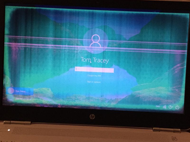

Hello - when I turn my laptop on, the screen goes as the attached image, with horizontal lines covering 99% of the screen. Only the top 1% is functional, the rest is frozen. Then after 3-4 minutes, it goes to normal and the laptop works fine.
it only does it when starting up usually. I tend to notice it is more common when I've taken the laptop with me for work during the day and it's been in my car boot in cold temperatures
is this likely to be a failing graphics chip?
Many thanks in advance

Is it happening only when you log in, or it happens randomly?
Did you try any troubleshooting steps?
Meanwhile, I would request you to re-start the notebook, keep tapping F10, and let me know if you see those lines in the F10 screen as well.

Hi Barachiel,
Thanks for getting back to me.
With regard to your questions:
Is it happening only when you log in, or it happens randomly? - Before this month, i'd say it happened twice randomly ie having been using the laptop for hours - but on the earlier occasions, the first of which occurred a month after I bought the laptop, it was only covering about a 10% band of the screen - shutting and re-opening the screen lid fixed this.
This month, since it has got worse as pictured, it only occurs when I turn the laptop on from a cold start, but not every time. It tends to be more frequent if the laptop has remained in my car turned off all day in fairly cold temperatures (not snow/freezing). However, it does occasionally do it having been in my home and turned on the next morning. It doesn't do it every time though, for example it hasn't done it for around 3-4 days now.
I haven't tried any troubleshooting steps and I will try the F10 technique when it next occurs but I imagine they will remain there, as I can still log-in with the screen lines and can see the screen has changed from the log-in to the actual Windows home screen in the top 1% that was unaffected - the rest of the screen was still frozen on the log-in screen.
Kind regards
Tom

Hi there, thanks for the reply.
I've just tried the F10 startup and the lines still remain on the screen.
When connecting to an external monitor, the external monitor has no problems at all.
