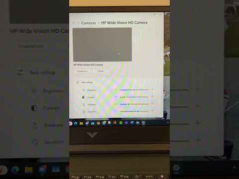

I am facing the problem with my hp wide vision hd camera (built-in camera). It is flickering on and off and i am not be able to use my camera. I have tried all solutions like from device manager solution, updating windows, reinstalling windows using the HP cloud recovery method. Still my camera is not working. I have daily meetings and camera has become very important for me. Please solve this issue and help me with that.
I am sharing one video of having exactly same problem with my laptop.:
https://www.youtube.com/shorts/w9uHGDmvGq0
